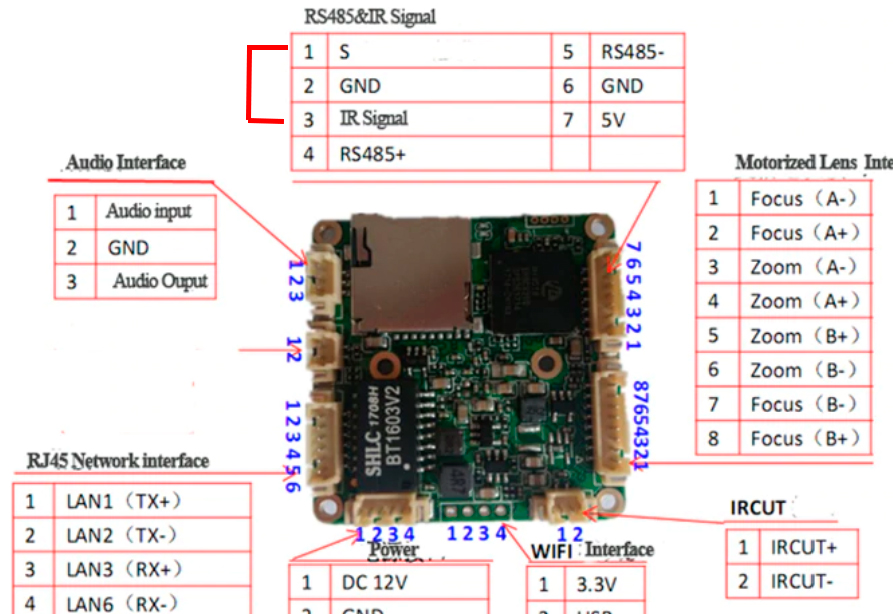

Hello,
I apologize if I ask for information in the wrong places and for my language, I am French ... and your forum is the place where you take care of the situation.
I recently bought this model https://aliexpress.ru/item/4000711798574.htmlthinking that it would be like my other camera models (XM520 + sc2235) that the IR cut and the N / D passage could be automatic without a led connected but it does not work like that, do you know how to just connect a photo cell on this board? pinout 1-S or 3-IR Signal? logic high or low?
other question do you know if there is a firmware to use this module with ICSee and Xmeye?
thank you

Прошивку для этого модуля смотрите на этом сайте http://www.ipcam.xin/

Сообщение pagpatrice » 10 май 2020, 06:20
Thank you for your answer, however I was looking for a firmware to work with ICSEE not Camhi but I think not possible ...
for the night mode switch, I found:
Pin 1 (S) must be in the High state with pin 3 (IR Signal = 3.3 v)
